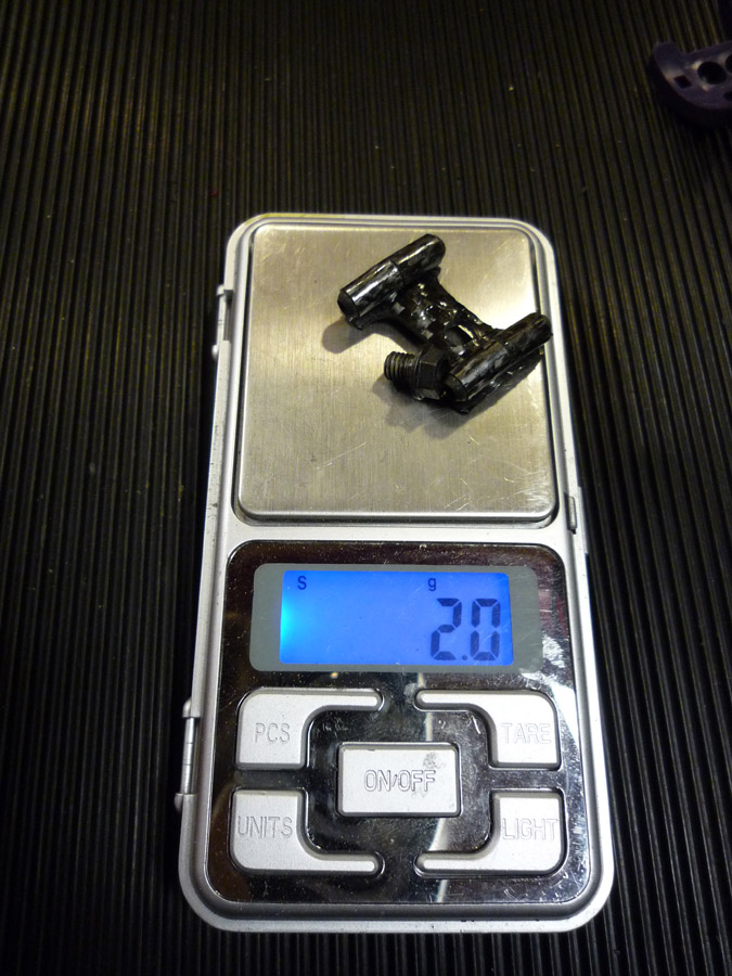

Messagede je9999 » Lun 30 Nov 2009 12:55
je9999
Messages: 994
Inscription: Dim 13 Juil 2008 15:15
Messagede je9999 » Lun 30 Nov 2009 13:01
je9999
Messages: 994
Messagede je9999 » Lun 30 Nov 2009 13:02
je9999
Messages: 994
Messagede Tytoune » Lun 30 Nov 2009 13:14
-2gr :lol:
Tytoune
